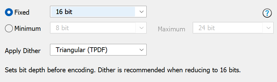

    Bit Depth
Bit Depth can be used on one of two ways, to force a set bit depth (for example the source audio file is 24 bit, and reduce to 16 bit). Or to increase bit depth to 32 bit (floating point), process other DSP effects (such as Graphic Equalizer), then set the depth back down to 16 bit, by including Bit Depth twice, first and last.
32 bit floating point allows the value of the audio signal to go over the clipping level (+-1.0), certain effects such as Graphic Equalizer can introduce increases over the maximum, before reducing to 16 or 24 bit, include Volume Normalize set to Peak to Peak.
Apply Dither can be used to dither when reducing the bit depth, such as after volume normalizing (at 32 bit floating point), dither in the final stage to 16 bit. Triangular dither is the preferred option.

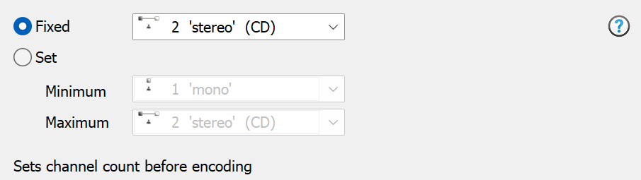

    Channel Count
Forces a channel count, or set allowed minimum and maximum channel counts as supported by a player.

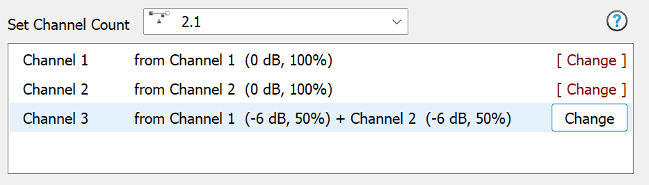

    Channel Mapper
Channel Mapper sets a desired number of channels, each channel can be edited, choosing which source channel(s) it is made up from.
In the above example Channel 1 and 2 are left untouched, and channel 3 is created from the sum of channel 1 reduced by 50% and channel 2 reduced also.

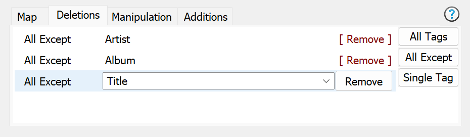

Deletions
Remove All Tags, All Except, or delete a Single Tag value. In the example all ID Tags are removed except the 3 listed.

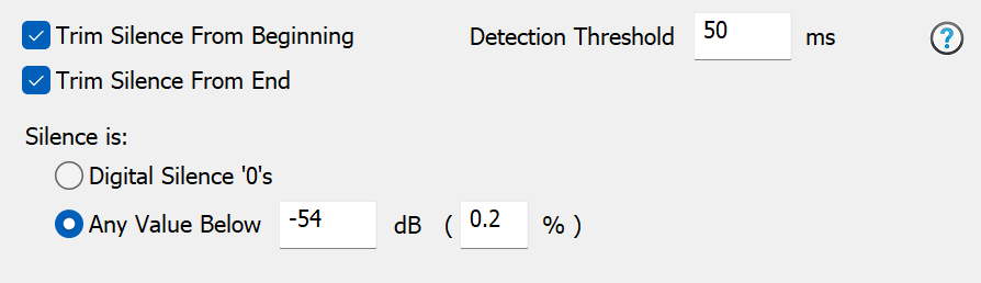

    Trim Silence
On certain tracks is silence present at the beginning or end of the track. This DSP effect can detect and remove such silence.
Detection Threshold sets the minimum time average audio levels have to go over the set silence value before it is classed as non-silence. If Trim Silence is eating audio it should not, enter a lower dB value, such as -44.
This effect is non-live.
