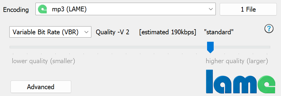

Compression Options
Lame offers 4 types of encoding:

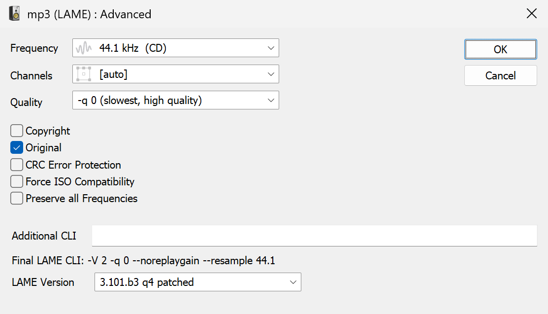

Clicking Advanced:
Frequency - number of samples per second to be encoded, [as source] allows the output frequency to match the input frequency (recommended).
Channels:
[auto] matches the channels to the source, for 2 channels Joint Stereo is used.
Mono a recording with only a single channel of information.
Joint Stereo - luckily for stereo compression sound on the left channel is very similar to sound on the right channel, Joint Stereo takes advantage of this similarity to use the savings on the 2nd channel to give higher quality compression.
Forced Joint Stereo - forces separate encoding of left and right channels, only recommended when high bitrates are used.
Quality specifies how much effort goes into compression, this mode is applicable to all types of encoding.
Copyright marks the MP3 file as containing copyright material.
Original marks the MP3 file as an original file (not a copy).
CRC Error Protection adds a checksum to each frame, a decoder is able to verify each frame has not corrupted, however very few decoders use checksums.
Force ISO Compatibility should be used if your player is having trouble playing MP3 files created by Lame.
Preserve all frequencies normally lame will reduce the upper frequency if the bitrate is below 300kbps, this allocates bit rate to the parts you can hear. This option forces lame to preserve all frequencies.
LAME Version allows selection of a specific version of LAME
