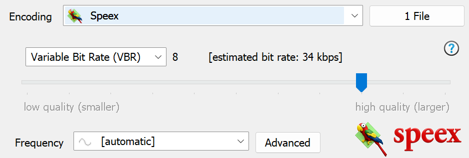

Compression Options
Speex offers 3 types of encoding:
Quality Target Variable Bit Rate (VBR) VBR files are made up from
100's of small audio chunks, called frames. Whilst encoding VBR,
the encoder decides which bit rate to use for each frame. Bit
rates can drop down to lower values when it is warranted (if
there is not much sound complexity) and switch up to a higher
bit rate when required. VBR files should be used when encoding
unless there is a specific reason not to,
Average Bit Rate (ABR) a little like VBR except constraints are placed on Bit
Rate so that over time it averages out to the desired value,
Constant Bit Rate (CBR) a constant bit rate is used throughout the encoding process.
Frequency number of samples per second to be encoded, [automatic] allows the output frequency to be set the same as the input frequency (recommended), whilst limiting to maximum and minimum allowed frequencies.
Advanced Options
Voice Activity Detection - if a period of silence is encountered the block is marked as silence instead of wasting bits encoding nothing. VAD is always used for VBR encoding.
File Based Discontinuous Transmission (DTX) - Discontinuous transmission is an addition to VAD/VBR operation, that allows to stop transmitting completely when the background noise is stationary. In file-based operation, since we cannot just
stop writing to the file, only 5 bits are used for such frames (corresponding to 250 bps).
Mono Down mix creates a single channel Speex file, if source channels are greater than 1 then they are combined into one.
Complexity set encoding speed/quality trade-off. The higher the value of complexity, the slower the encoding.
