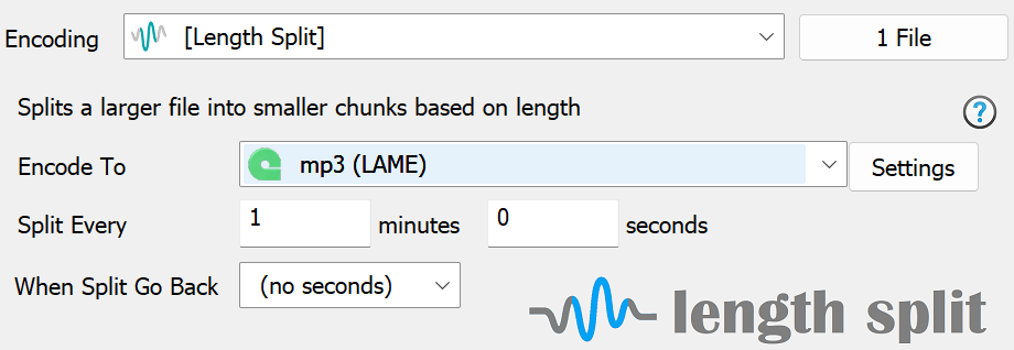

Splits a larger file into smaller "chunks", for example a 4 hour audio book could be split into ten 24 minute files, which are more manageable.
When splitting the new split filenames are {Original Filename}-001, -002, -003 for the first, second and third files.
Options
Encode To specifies the encoder the shorter files should be encoded with.
Split Every sets the length to split.
When Split Go Back can be useful with audio books so the new split file contains a portion from the end of the previous split file, when listening to a narrative it is good to get the last sentence again by jumping back 10 seconds.
